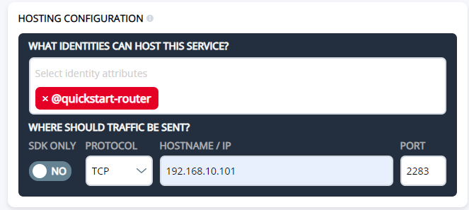

Instead of having the all-in-one image hosted on oracle vps, then enrolling a LXC or VM from inside my network to that vps, can I accomplish the same by avoiding the vps all together and just host the all-in-one image inside a VM in my network and just configuring the "hosting configuration" in a Service to @quickstart-router and send the traffic to an IP address inside my network? eg:

You're asking if you can run the all-in-one quickstart in a container in your private network instead of a public VPS. Yes! These are the required network flows, i.e., firewall exceptions:
  1. all identities and all routers must reach the controller's advertised address:port
  2. all identities must reach the router's advertised address:port
The advertised address:port must be reachable by all devices running Ziti, so if the address is a domain name then all devices must also be able to resolve that domain name to the correct IP address.

Great! I think I got this working now for a few of my service hosted internally.
My LXC or VM was on Ubuntu Noble w ZET 1.2.2. Perhaps my issue w high CPU was a combination of that trying to connect to an arm64 based all-in-one image on the Oracle vps? In any case, bypassing that (ie hosting the all-in-one in a Noble based VM in my network) seem to be working. I have been slowing setting up Services through ziti and making those service on my nginx reverse proxy accessible to my internal network only.
