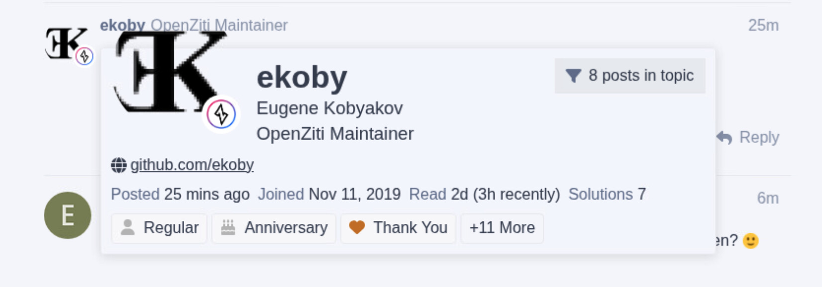

Thank you but when I click on ikoby, I don't have the Message button.
This is what I see
that's frustrating. I'll see if that's some sort of discourse permission and follow-up
