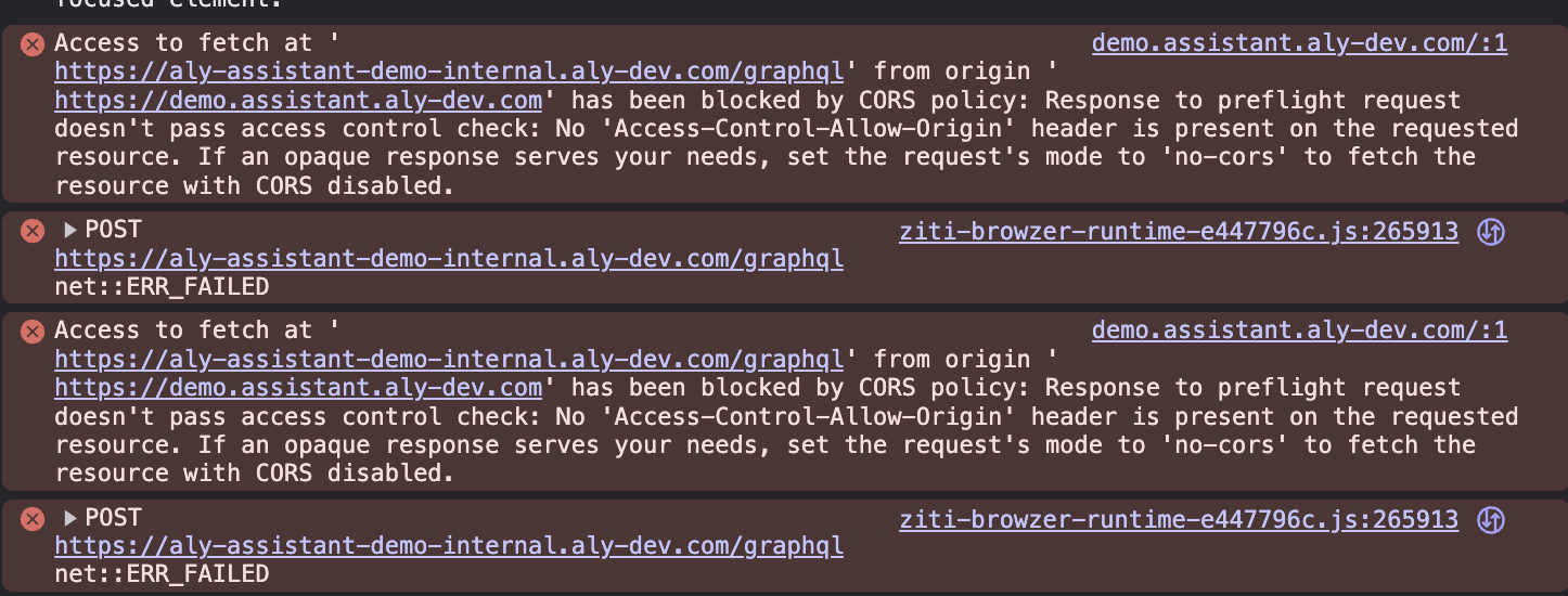

for testing i ve removed api vhost from browzer targets and added backend api endpoint also to same ziti service, in the debug logs on config i can it is intercepted. But still it fails with cors issue
after removing backedn api from browzer and mapped (backend endpoint)into same service as UI, It is not rechable, not sure what im missing here. help me fix this!

After upgrading to version 0.80, Browzer continuously loops with an "invalid scope" error and fails to display the login page. Clearing the app storage via developer tools did not resolve the issue. In contrast, the login page functions correctly in version 0.76.0. Is it necessary to add any scope or audience parameters in the environment settings within Browzer's bootstrap targets?
I ve tried both on kubernetes and ubuntu deploying browzer bootstrap, it is throwing me same isssue. it just loops throwing error as invalid scope. But it was redirecting to login page on 0.76.0 but only backend was not accessible.
So not sure what im missing. Please do help me to fix this?
@curt
Disregard my previous issue. After adding idp_authorization_scope to the Browzer targets configuration, it started working. However, my earlier issue persists — the backend URL is not being resolved despite the service being mapped in the identity policy. I am getting a 404 error, and it seems the ZBR runtime is not properly intercepting the backend URL.

I can confirm intercept url is listed in
https://xxxxx.xxxxxx/edge/client/v1/services?limit=100
not sure why api is not accesible? am i missing some configuration and i dont find any relevant errors too.
@curt Any idea why it is not working?
Can you set your client-side loglevel to TRACE, retry your flow, then send me a zip of your console log (in a DM)?
