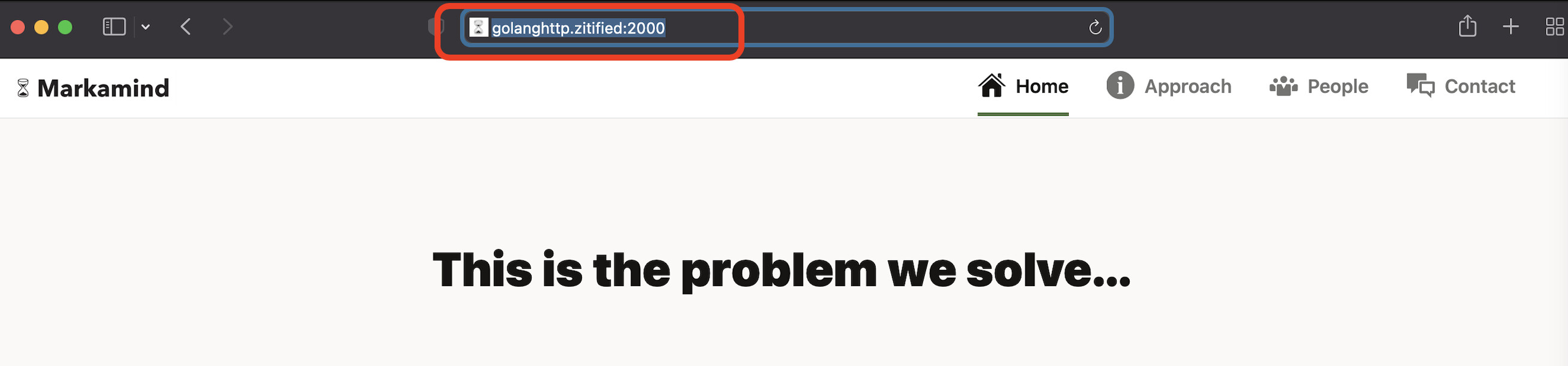

Hey… after a few days of mental rest… I realised there was a bug in the golang code :slight_smile:
See below … providing evidence that I now have the reverse proxy working…
BIG congratulations! Now you should make a github repo and push it out for the world to use!!! :slight_smile:
will do..
this means that any app can now be zitified.. by simply putting it behind a zitified reverse proxy
