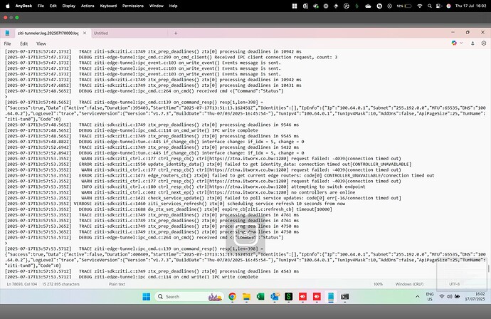

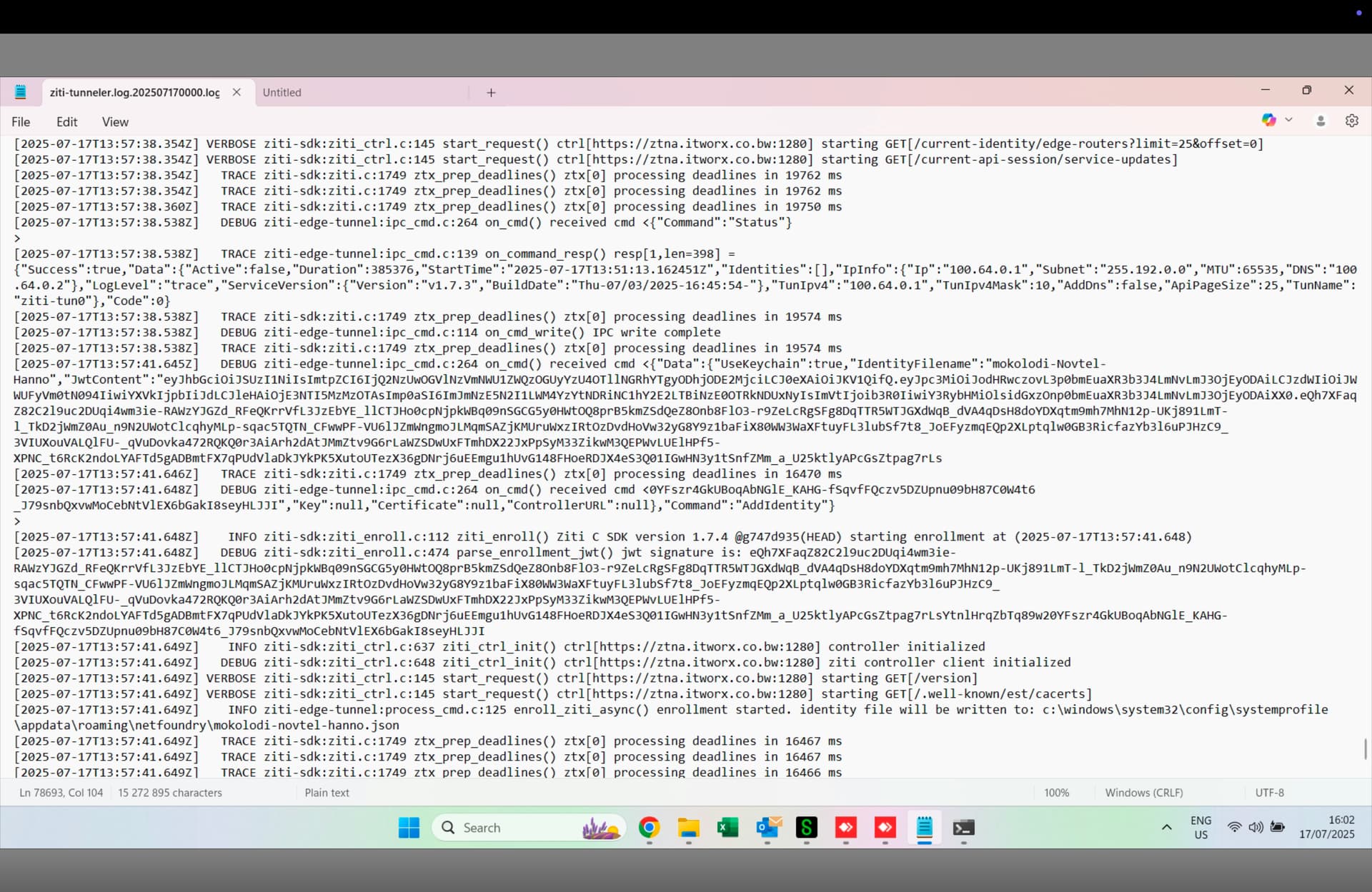

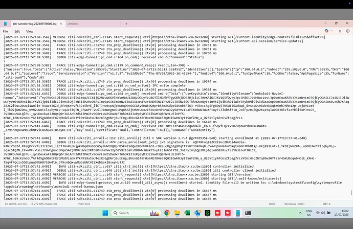

We're encountering an issue with a user in South Africa who is unable to use the OpenZiti network. They are able to enroll their identity successfully, but the connection to the controller only happens once — after that, it fails to reconnect.
The user has multiple VPN clients installed. I assume OpenZiti should work as long as those VPNs are not running — is that correct?
Would appreciate any insights or suggestions on what else could be causing this.

From the log snippets you posted I don't see any errors and I see the user successfully enrolled. My guess is that the user is not able to connect to the routers? You need to scan through for errors in the log.
I don't know if I'll be able to give you any good support here on this one, it seems like a tricky problem that is probalby going to be hard to do via internet support forums. :frowning: It feels like a deeply network-related issue most likely.

Will comb through those logs. Is there anything specific that I could look out for when combing through the logs.
