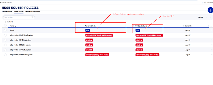

@TheLumberjack I think i would do the following but like to hear your views before committing
I would set Router Attributes to SG, HK ,JPN etc. (tied to our public routers attributes group)
keeping identity as all since we want all identities to have access to these public edge routers and using it to connect to their private edge.
the concern is on private edge below (in Red) i assumed they would be able to connect to public router since identity set to all right ?
Edge Client (#all) –> Public Routers (SG,HK,JPN etc.) –> Private Router –>Service
Hope i am thinking it correctly.
Sounds like you understand what i was trying to convey.
I'm not sure where/what the concern is. These other policies are system generated and are specific to each router. Those apply only to the router.
The public routers would be the onboarding routers for identities into the OpenZiti fabric. Once connected, those identities would be able to leverage any private routers for offloading traffic assuming those private routers are authorized for the identity and service being dialed. (Hopefully that makes sense)
First, add the attributes to your routers (you didn't show those, i assume you did that). Once the attributes are added, you would change that one #all to #SG, #JPN, etc. I think you understand

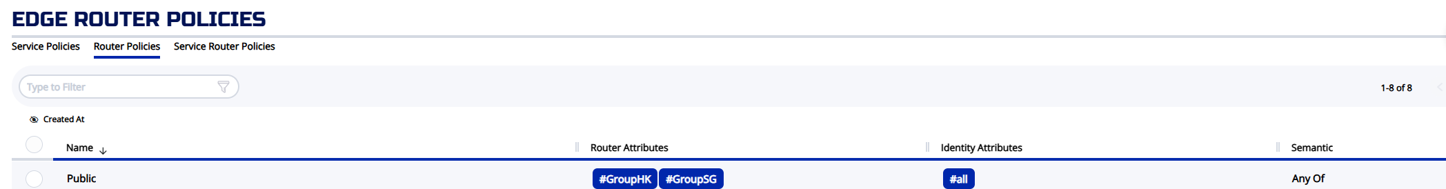

Router policies as shown - Changed #all to more specific group(attribute) while identity remain all since we want any edge client to utilize these global public router as transit.
Is my understanding correct?
Yes. Your understanding is correct.
thanks @TheLumberjack
I confirmed after setting this, no more errors of edge attempting trying to connect a private edge.
This allowed me to exposed only managed Public edge to tenants.
