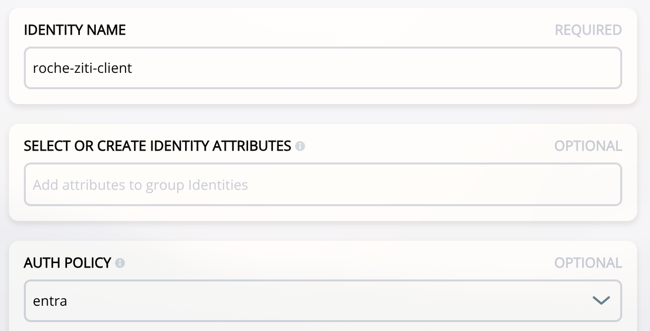

My identity is using the "entra" policy:
The auth policy uses the entry JWT signer:
And the entra JWT signer is enabled.
Restarting the tunnel doesn't fix the issue.
Try assigning the default policy to see if that matters (we would hope it doesn't). I think @ekoby is gonna have to have a look at this. I don't quite see why it would fail if the zit CLI succeeds
Jackpot! Assigning the default policy works! Is this expected or is it weird behavior?

there seems to be some unexpected behavior when the signers are enumerated in the auth policy. I am looking into that.
The workaround is to let user authenticate with any of the configured signers (if you only have one then the outcome is the same)
