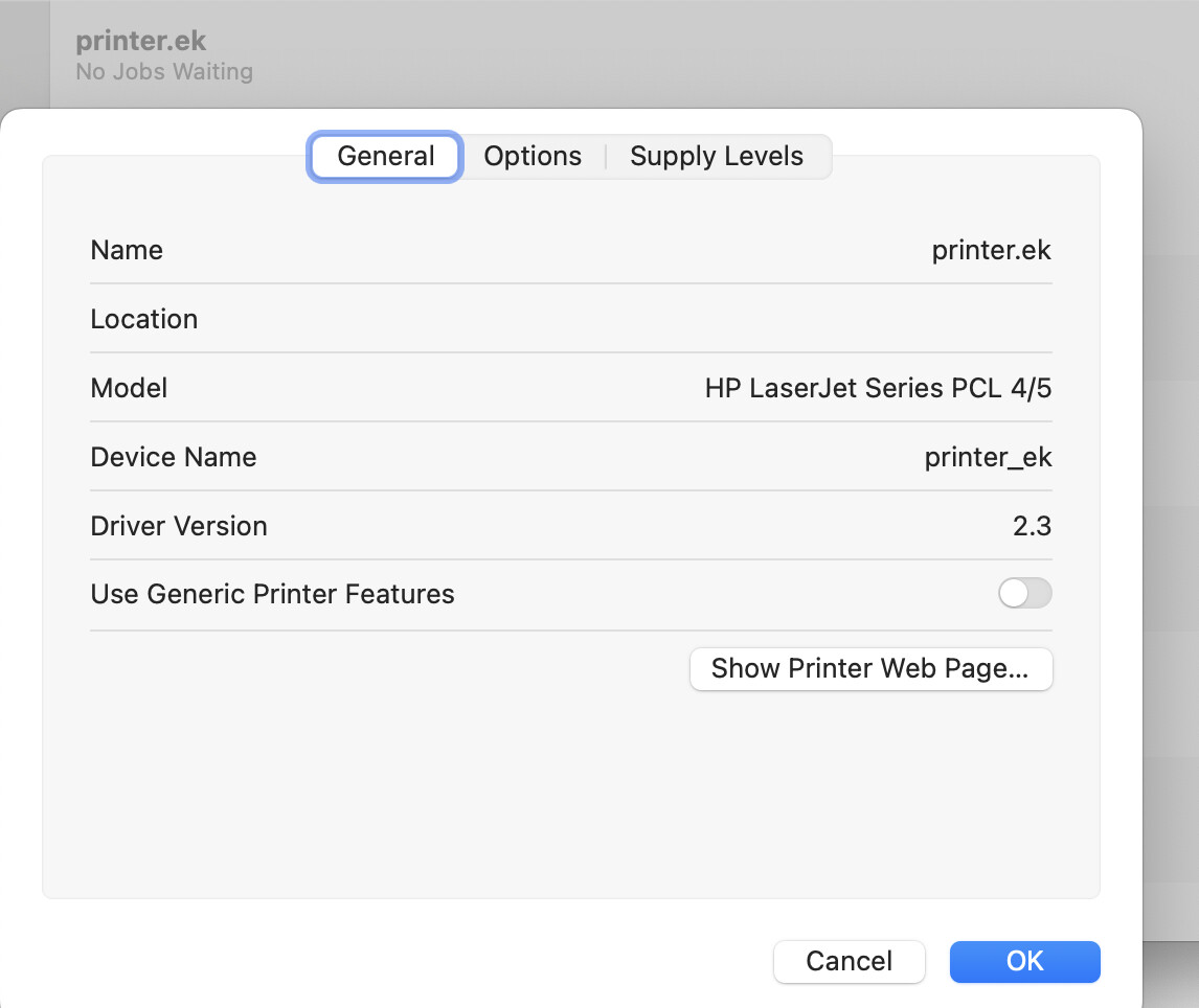

I was able to setup my home printer for over-ziti-access:
  1. service:
  2. configuration
    print-host (host.v1):
  "address": "192.168.33.222",
  "forwardProtocol": true,
  "forwardPort": true,
  "allowedPortRanges": [
      "low": 0,
      "high": 65535
  "allowedProtocols": [
    "tcp",
    "udp"
  "httpChecks": [],
  "portChecks": []
print-intercept: (intercept.v1):
  "portRanges": [
      "low": 0,
      "high": 65535
  "addresses": [
    "printer.ek"
  "protocols": [
    "tcp",
    "udp"
  1. service hosting is assigned to a rPI on my home LAN
  2. I can print from my MAC over Ziti:
  3. I can add it on my Android device
