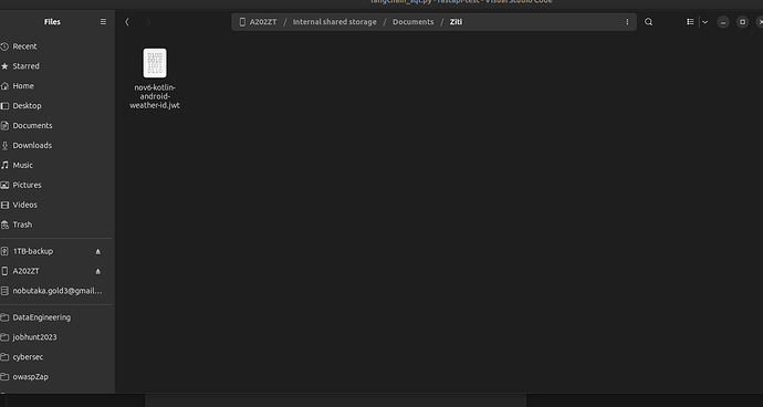

Screenshot (for my second question below):
That is the id I downloaded from Net Foundry and uploaded to my Android device sitting in my Documents/Ziti folder.
That's for the Kotlin weather app example.
I know in Flutter there is secure storage but I thought I recalled for the Ziti Edge app's documentation it said something along the lines of "Just put the identity anywhere and the app will find it. " Is this true and if so is it safe?
Also where are the identities stored if I scan the QR code?
I'd get that working first and layer on a second for of encryption later. The .jwt that's returned is very short-lived so for my money, https is "fine" since once you consume it, it's useless anyway... I personally probably wouldn't bother with another encryption.
This is true and 'safe' for the same reason stated above wrt transferring the jwt. Once it's consumed/enrolled that file is utterly useless. On mobile devices, the devices use application storage and/or the app's keychain for storing sensitive files so that's probably what you are wondering there?

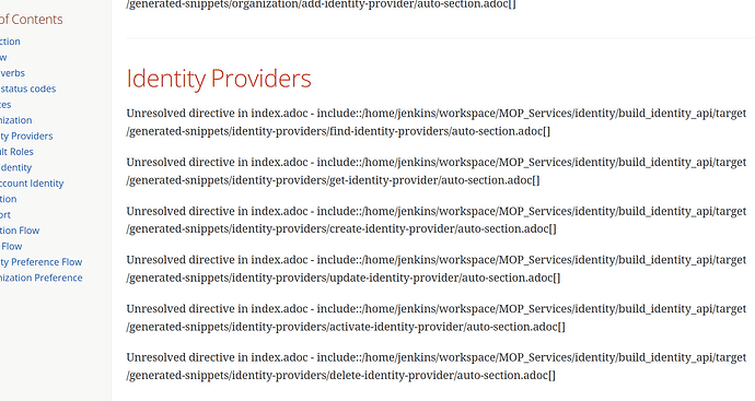

From References - I try to open the Identity API page: NetFoundry Identity Service Guide
but it's full of error messages:
so I can't read any of the documentation hence I asked here on how to do the identity issuing programatically.
sure enough. i'll mention it to the team and see if we can get that fixed. thx for pointing it out
