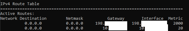

So the problem is happening again for me and I think I can guess what’s going on. Here’s my ‘route print’ command for today:
Nothing changed except the order in which the first two routes are listed. That implies to me the client is blindly grabbing the first route in an enumeration statement. It’s assuming there could be only one gateway and not evaluating anything else. Would a simple fix be to grab all 0.0.0.0/0 routes, and select the one with the lowest metric? Then tie the controller route to that?
I just confirmed this is the issue. I wrote a powershell script that deleted and re-added the control network 0.0.0.0/0 route in order to force it down on the list. Then I restarted the openziti client service. Openziti picked the first route again, which was the right one this time and worked.

Since windows prioritizes traffic to go through the route with the lowest metric, this will still work and additionally catch the scenario I brought up. I suppose this will also keep things working in networking scenarios where two NICs are configured in active/active where one is the failover nic as defined by said metric.
Thoughts?
The current implementation should handle the preferred route going down, because if_change_cb will be called when that happens, which will cause the tunneler to re-evaluate the (best) default route and update the existing exclusion routes accordingly.
What about upstream failures that don’t trigger an if_change_cb event?
My revised proposal in the case of two routes like so:
Active Routes:
dst 0.0.0.0/0 gw 10.4.4.1 if 10.4.4.20 metric 20
dst 0.0.0.0/0 gw 10.2.2.1 if 10.2.2.128 metric 2000
You’d get two exclusion routes like so (assuming controller ip is 5.5.5.5):
dst 5.5.5.5/32 gw 10.4.4.1 if 10.4.4.20 metric 20
dst 5.5.5.5/32 gw 10.2.2.1 if 10.2.2.129 metric 2000
WIndows allows for this as long as the metrics are different.
If an upstream where a router goes down in the 10.4.4.x network, packet timeouts should trigger windows to resend over the next lowest metric.
Scratch that – just checked my answer. Windows doesn’t route to the next lowest metric until an interface status change is triggered, which would fire off the event anyway, rendering this not entirely necessary.
I still feel like my revised approach is likely to catch some fringe scenarios in windows networking land, but I honestly can’t picture any with my limited knowledge. So I’ll be happy to test the results of whatever you decide to push through as a result of all this back and forth.

Not sure if there’s an issue. I have this in my log:
[2025-08-07T20:51:24.064Z] INFO ziti-edge-tunnel:tun.c:469 update_default_route() default route is now via if_idx[6], metric=0
However the exclusion route placed in my route table shows a metric of 20. 20 happens to be correct. So the output is good, but the log doesn’t reflect accurately.
