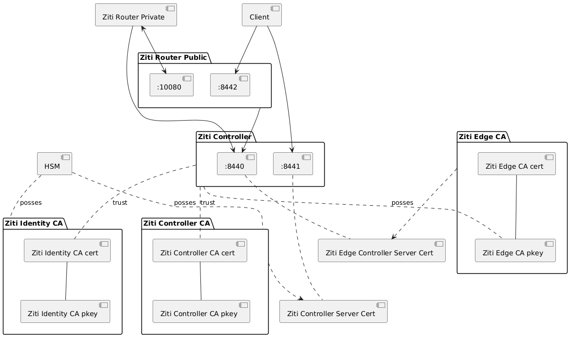

So now I understand that a controller only needs to own two server certs and one CA to create identities.
Questions:
  1. Are those routers in a video two separate ones? Or just one but splitted into two for the sake of visibility?
  2. Is it correct that a client and router must establish mTLS? And they use their certificates both signed by the same CA to trust each other and establish the connection?
  3. Is it correct that those IPs and DNS names that are included in the SAN of a server certificate are about the server where controller is running? So that peers(client and routers) could verify it?
  4. Is it correct that the ziti sdk for applications establishes an outbound bidirectional connection with a router and uses a unix socket to let those ingress and egress bytes be handled on the user-space(business logic) application level?
  5. Is it possible to manually create each certificate, including identity? Consider the following diagram.
Could be either really. It was meant to be a logical representation. Since the router on the left looks to be connecting/forming a link to the router on the right:
I would presume this is two routers. The router on the left has a dialer but no listener so it'd be a router in private networking space. That router connects to the router on the right so the router on the right could be in the same private address space, or it could be in some other address spaces addressable from the router on the left. In your diagram that'd be the "Ziti Router Private" connecting to the "Ziti Router Public" (a line you don't have shown yet).
Mostly, yes and in nearly all regular/normal setups this is the case but it's not necessary for it to be the same CA, the router just needs to trust the certificate presented. So if the router was setup to have multiple trusted CAs, then it wouldn't have to be the same ca. To me, it's the 99+% use case/expectation that they'll be the same CA since that's how the quickstart works and frankly it's just easier. I don't know of anyone using > 1 CA but I'd expect it's possible and would work (i've never tested this either) :).

My questions about all the CAs are about hardening the trust further. By using some HSM like Yubikey and explicitly signing new certs for each parts of the infrastructure by this HSM.
I know that it is possible for authorizing endpoints as described in the docs, but I wondered if it possible to go further with this to moving the control of private keys of CAs to the HSM. So that even if controller could be compromised, the attack surface of that could be a little lower. I pretty much understand that if controller node is hijacked you have many more other problems than just posession of CAs, but yeah, just curious.
Well. You know -- you could offline the key used to sign identities after getting your overlay and identities all setup by removing them and "put them back" afterward. I never considered that but as long as the controller isn't trying to sign any CSRs etc, I think that'd work but I've never tried it.
I am pretty sure the router/controllers don't work with HSMs yet but that seems like a logical thing for a future feature enhancement.
So, is this correct?
The only thing that I miss here. Does 'Ziti Router Private' has an explicit trust for the cert of the 'Ziti Router Public', or does it have trust for a 'Ziti Edge CA' and so a descendant cert is trusted?
And a little bit unsure which cert from which CA goes into ':8440' and ':8441' controller's port.
When a router dials the link listener of another router or when the router connects to the control plane of the controller, the certificate the router presents needs to be trusted. That trust is configured through the identity.ca section of the config file.

As for which cert goes where, that's actually where the quickstart's PKI is useful to explore. A controller has two main identity sections. One at the top/root level and another located in the web.name.identity section. The top identity block is for the control plane (port 8440) while the web.name.identity section overrides the root identity section and is applied to just the HTTP-based port/s (8441). You don't need to use both identity blocks, the quickstart does it this way to try to show you that you can have a separate PKI for the HTTP endpoints located in the 'web' section...
Hope that all makes sense
Alrighty, seems like this look better now:
Is there anything that I miss here?
Top right callout:
The "privateness" of an edge router to me, mainly refers to whether they have exposed ports. When you make a "private" edge router config, the edge WILL be enabled. This is because these edge routers are very often used as egress/exit nodes for traffic, which means they act as a tunneler, which means they need to have the edge functionality enabled.
On top of that, it's often useful to have one or more routers local so that local OpenZiti traffic doesn't need to go out over the internet and back, it can remain local, and thus will obviously have less latency.
So I think that's the only tweak I'd make .
So that 'Ziti Router Private' just has ':8442(:3022 default)' port opened to the private address space, and doesn't have :10080 port opened, so that other routers can't connect to it. Correct?
If so, what is the differece between an edge router and fabric router?. In cli they have distinct names, but essentially edge router is just a superset of a fabric router. Above you said that these fabric router 'usually will have edge functionality enabled' but what's the point if it doesn't? What if a router doesn't have any ports opened(no edge basically) and it can only dial the other router?
I don't think I can answer this question, let me turn it around... A router config file made with --private will not have a link listener and will have no link listener port defined, thus there will be no port open locally OR publicly for routers (even local routers) to connect TO. If you want a local mesh like that, you'd not use the --private flag, and you'd rely on your firewall/s to block that port preventing other devices from tryign to connect to thatt port... I hope that makes sense...
It's easy and complex and nuanced all at once.... It comes down to the router's config file. If the router has a link dialer or a link listener, then the router participates in the fabric and is a "fabric" router. This is probably every router. So, a slightly more refined way of thinking of this is that a "fabric" router that does NOT have edge functionality enabled is only considered a "fabric" router.
If the router has "edge" enabled services AND that router has link listeners/dialers defined, well then it's (per the definition above) should be considered a "fabric" router. But really, an 'edge router' implies more functionality than just the fabric. So in general, if the edge functionality is enabled we call those "edge routers" to indicate that it's "maybe a fabric router, but definitely an edge router".
It's confusing terminology that makes sense the deeper you're into OpenZiti and it's one of the reasons you'll find me usually only using the term (or trying to) 'router' now-a-days.
The ziti create config commands are not meant to cover every single permutation of router configuration available, it's just too many permutations to cover for us at this time. Instead they are intended to provide a foundational understanding of what these config files look like with some customization options. Largely through environment variables. There are a few flags that influence some settings, but undoubted, we'll never cover all of the permutations...
As for the differences... I'd recommend you give them a try and see.

Here you can see the "--private" flag simply added comments to the link listener section, thereby disabling link listeners
fabric configs have much more commented out. the

Now it makes sense to me. Really is. I think this explanation has to make to the docs. Because I haven't seen as good explanation as this one anywhere. Apart of pieces in the old doc of fabric repo I mentioned above, some videos, and implicitly mentioned pieces of it in the doc.
I think also the definition of Edge has also make it to the docs.

and just in case the source of the diagram is needed
I don't understand for what client certificates are created and added into identity.cert and web.identity.cert sections.
Is it correct that identity.cert and web.identity.cert respectively is ONLY used by a ziti cli?
Like path parsed from the config file if provided, maybe?
In the video above where you talk about PKI you don't really go into details of what client certs are used for. Except for 'sometimes you need to present a certificate to a piece of equipment'. I tried searching both in the documentation and forums here and could not find the answer.
edit:
found in a recent video on Ziti TV where you go step by step you mention that identity.cert would be used to connect to other controller, so I presume it's kind of reserved for the upcoming HA feature, or when controller initates a connection itself to some machine on the network?
but what about the web.identity.cert which is used for Edge API, is it the same type of thing?
I expect you are constraining your question to controllers only because for routers, that .cert field is used all the time when the router contacts the controller or other routers... Currently for controllers both of those cert field are never used. The simple answer is this is a reused config block and although the fields aren't used at this time by the controller, they might be in the future (as you discovered after i read your 'edit'). But for now, yes, those fields are unused by controllers. Definitely used by routers though....
It's not used by the ziti CLI at all as far as I know. The ziti CLI uses information stored in $HOME/.config/ziti-config.json or you use the certs/keys specifically during ziti edge login.
I suspect this field is literally never used. I would expect when we support > 1 controller that the root identity section (the one I think of as controlling/configuring the 'fabric', not the 'edge') would be the one in use but to be 100% clear, I've not dug into how HA controllers work just yet myself, so it's only an educated guess on my part at this time...
Makes sense. Yes, it was about controller's config. Forgot to mention.
Thanks!!
