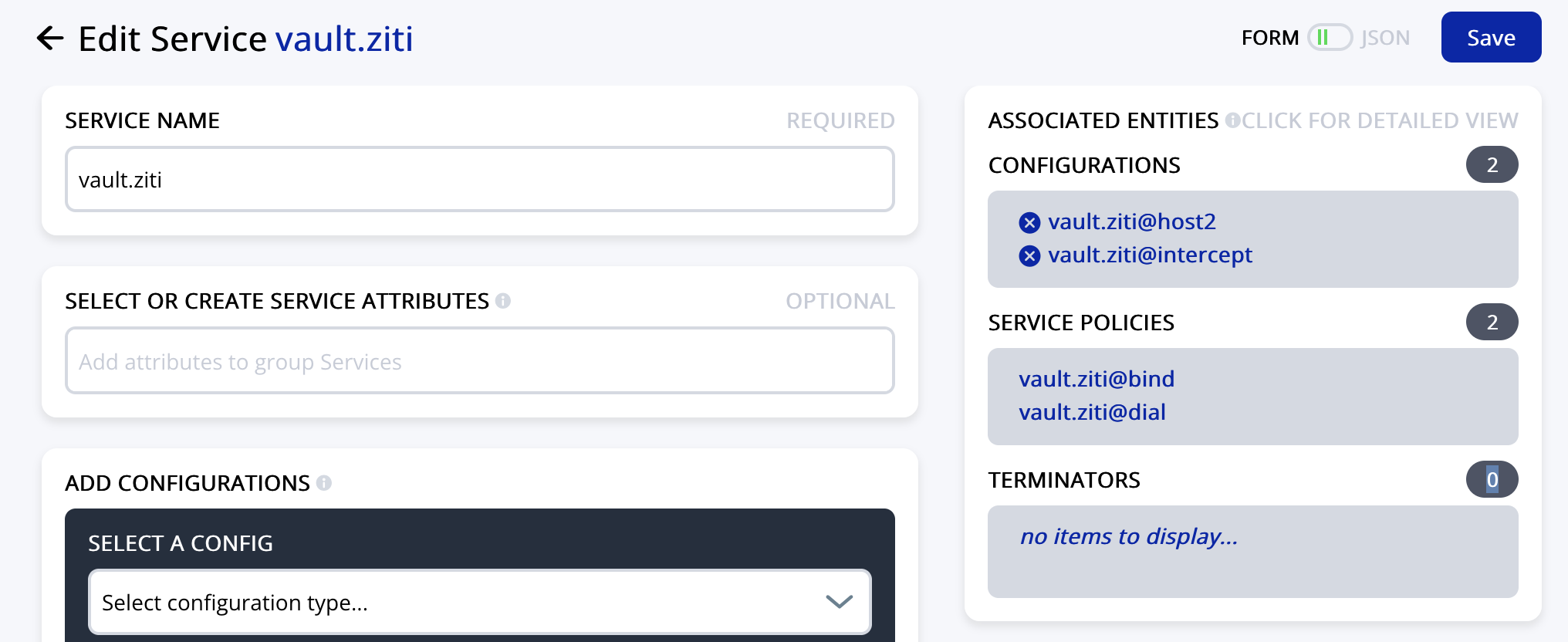

host v2
ziti edge create config "vault.ziti@host2" host.v2 '{"terminators": [{"protocol":"tcp","address":"vault-active.vault.svc.cluster.local","port":8200}]}'
New config vault.ziti@host2 created with id: 6UN2wD8S6ef6ERulSruau3

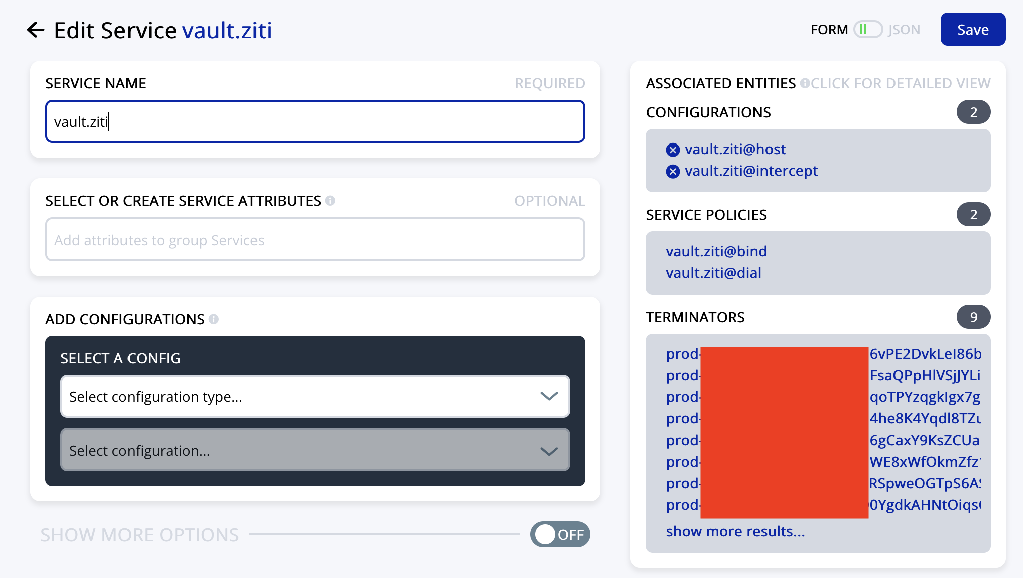

host v1
For host.v1 everything is ok. Terminators will create automatically!
ziti edge create config "vault.ziti@host" host.v1 '{"protocol":"tcp","address":"vault-active.vault.svc.cluster.local","port":8200}'
New config vault.ziti@host created with id: ll8GaeRL4pJG4LQqgOGNv

Results
Host V2
Host V1
Lets try to switch to Host V1. For host.v1 everything is ok. Terminators will create automatically!
Hi @zhilyaev
I'm pretty sure ZET doesn't support host.v2 yet. This is because host.v2 is most useful for ER/T (edge-router running the tunnel module) installs.
Picture a scenario where you've got a service that is horizontally scaled out, maybe a stateless web front-end.
If you're running tunnelers, you'd most likely have a tunneler co-located on each of those hosts, with a host.v1 config pointing to the same localhost address. If each ZET bound to 3 routers, and you had 10 web servers, you'd end up with 30 terminators for the service.
If you were running ER/Ts, you'd probably not have them co-located, rather you'd have 2-3 ER/Ts in front of those web servers. In order to reach all of the web servers, you'd need to tell each ER/T about each of the web servers. You'd do that with a host.v2 config, with a terminator for each web server. If you had 3 ER/Ts, and 10 web servers, you'd again end up with 30 terminators.
The goal is for the ZET to support host.v2 at some point, just to reduce confusion, but because it doesn't fit in with how it's used most of the time, it hasn't been a high priority.
Hopefully that makes sense.
Paul
