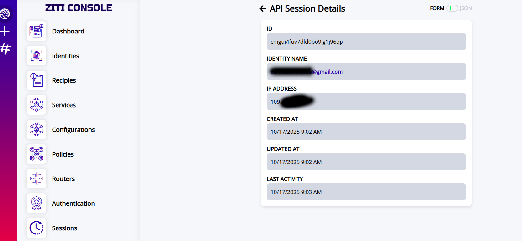

  1. So you are telling me that, if controller/router is on remote server and a user connects from his matchine, running tunneler, the ip address in api sessions can be other than the public one? From my tests, it shows public ip. Screenshot attached.

  1. The address should only be different if the client is using NAT. If that's the case, it will show up as the ip address of the NAT gateway. In this scenario, multiple clients could be in the same private subnet and would show up as the same IP address to the controller (assuming the controller is not in the same subnet.
