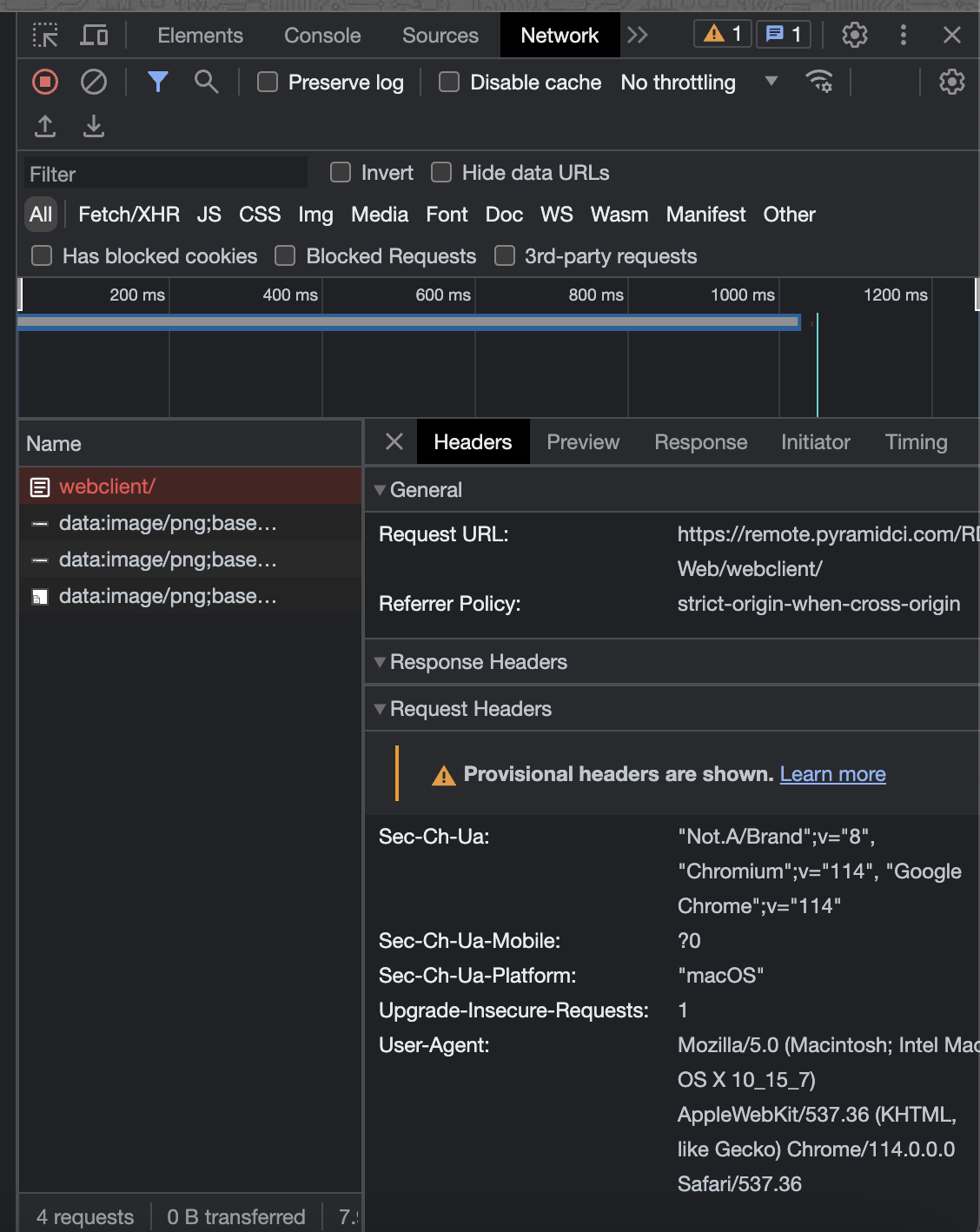

Can you fire up devtools (F12 or via the hamburger menu), try to access the site and show me what the network view looks like? You’ll be looking for any ‘red’ rows that would indicate some kind of failure.

Yeah. What’s that first “webclient” 301 redirecting you to?

Can you click on that top webclient and click ‘copy link address’? Or inspect the headers/payload?

Still gonna need you to click on that very first row that says “webclient/” please. I’d like to see if that’s a 301 too. I suspect it is and it’s sending you to “remote.pyramidci.com
And now would you do the same when the openziti client is on? Notice that’s a 304 not a 301. 304 means it’s not changed so just use whatever is in the cache. That other post showed a 301. Let’s look at that now
Unfortunately, we need to see those “response headers”. Specifically we need to see the ‘location’ header.

Showing the 301:
Showing the response header - location:
so how do I get that?
it says there are none
