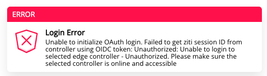

While trying to connect to ZAC to our SSO solution (Entra), everything in the configuration looks perfect but I am unable to logs in.
The error I recive in the UI is:
When looking on Ziti’s logs:
{"file":"github.com/openziti/ziti/controller/model/authenticator_mod_ext_jwt.go:285","func":"github.com/openziti/ziti/controller/model.(*AuthModuleExtJwt).pubKeyLookup","issuer":"https://sts.windows.net/<tenant-id-censored>/","kid":"HS23b7Do7TcaU1RoLHwpIq24VYg","knownIssuers":["https://login.microsoftonline.com/<tenant-id-censored>/v2.0","https://login.microsoftonline.com/<tenant-id-censored>/v2.0","https://login.microsoftonline.com/<tenant-id-censored>/v2.0"],"level":"error","method":"ext-jwt","msg":"issuer not found, issuers are bit-for-bit compared, they must match exactly","time":"2025-10-09T16:47:14.469Z"} {"authMethod":"ext-jwt","file":"``github.com/openziti/ziti/controller/model/authenticator_mod_ext_jwt.go:422","func":"github.com/openziti/ziti/controller/model.(*AuthModuleExtJwt).process","level":"error","msg":"encountered`` 1 candidate JWTs and all failed to validate for primary authentication, see the following log messages","time":"2025-10-09T16:47:14.469Z"} {"authMethod":"ext-jwt","error":"jwt failed to parse: token is unverifiable: error while executing keyfunc: INVALID_AUTH: The authentication request failed","expectedAudience":"","file":"github.com/openziti/ziti/controller/model/authenticator_mod_ext_jwt.go:88","func":"github.com/openziti/ziti/controller/model.(*candidateResult).LogResult","issuer":"","level":"error","msg":"failed to validate candidate JWT at index 0","time":"2025-10-09T16:47:14.469Z","tokenAudiences":""}

Hi @NullZiti, welcome to the community and to OpenZiti!
This error stands out to me. It makes me think that perhaps the jwks uri is incorrect.
You shared the first parts from the ziti ops verify command but you didn't share the final part.
Do you get a "login succeeded"?
INFO    attempting to authenticate to controller with specified target token type: ACCESS
Token: xxxxxxxx
INFO    login succeeded
If you get login succeeded, then the next thing would be to have a look at the ZAC in developer tools -> console to see if there's anything wrong listed in there. Perhaps the user you are logging in with is NOT marked as an admin? That's really easy to miss as it's under the 'Show More Options' and is a toggle:
My guess though is that the jwks uri is somehow wrong since the controller can't connect and verify the token. (that's what it looks like to me)

I also added the required callback URI for the authentication test, and it now returns a different error code from the login page:
And last, the error log from the docker:
{"authMethod":"ext-jwt","file":"github.com/openziti/ziti/controller/model/authenticator_mod_ext_jwt.go:422","func":"github.com/openziti/ziti/controller/model.(*AuthModuleExtJwt).process","level":"error","msg":"encountered 1 candidate JWTs and all failed to validate for primary authentication, see the following log messages","time":"2025-10-09T20:59:51.138Z"} {"authMethod":"ext-jwt","error":"jwt failed to parse: token signature is invalid: crypto/rsa: verification error","expectedAudience":"","file":"github.com/openziti/ziti/controller/model/authenticator_mod_ext_jwt.go:88","func":"github.com/openziti/ziti/controller/model.(*candidateResult).LogResult","issuer":"","level":"error","msg":"failed to validate candidate JWT at index 0","time":"2025-10-09T20:59:51.139Z","tokenAudiences":""}
