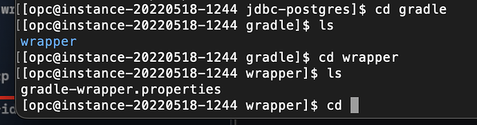

The gradle directory is missing the jar file
I will copy this from another directory and try again :slight_smile:
