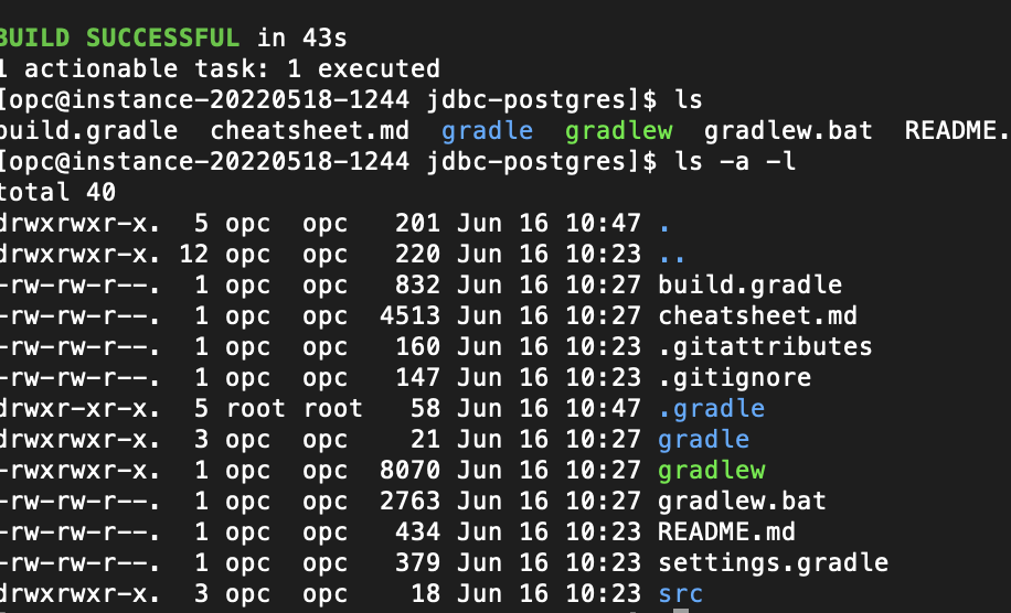

That seemed to work… but I cannot find the files
Any ideas?
ahh… you need to use

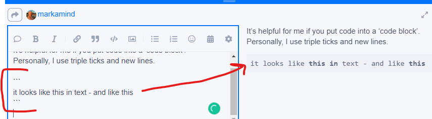

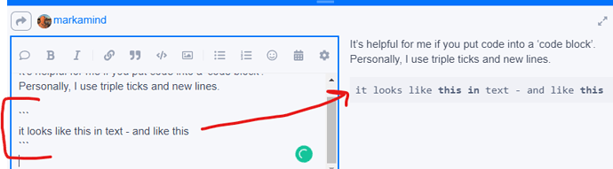

It’s helpful for me if you put code into a ‘code block’. Personally, I use triple ticks and new lines.
it looks like this in text - and like this
It greatly helps if I can copy/paste your output. I thought Discourse had a “code block” button in their WYSIWYG editor, but I’m not seeing it. ![]()

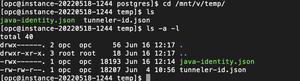

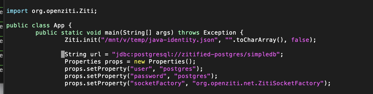

My guess is that you didn’t edit src/main/java/jdbc/postgres/App.java and it’s still pointing to “c:/temp”. Edit that file, make it read Ziti.init("/tmp/java-identity.json", "".toCharArray(), false);.
Once you do that, copy your identity to /tmp/java-identity.json and it should “just work”. I just did these two steps in my linux environment and here’s my output:

I pushed a small change to the App.java just now. Now if your identity file doesn’t exist you’ll see an error like:
Exception in thread "main" java.lang.Exception: Identity file NOT FOUND. The first argument should be a path to the identity file. If not supplied the default path [/tmp/java-identity.json] is used.
at jdbc.postgres.App.main(App.java:41)
Execute with gradle using:
.\gradlew run --args="C:\temp\java-identity.json"
./gradlew run --args="/mnt/v/temp/java-identity.json"
