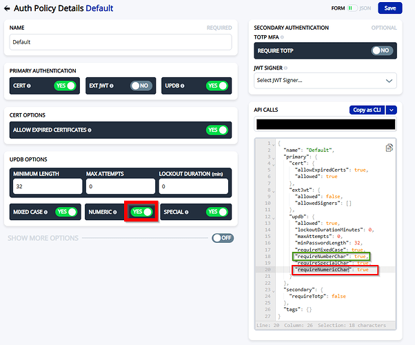

I’ve encountered two issues after modifying the default authentication policy on my Ziti controller using ZAC, that I would need help with. One is a minor inconsistency, and the other is more concerning from my point of view.
Incorrect JSON Key for Numeric Password Requirement
When enabling the “Numeric” password requirement via ZAC, the UI adds the key requireNumericChar to the JSON object, prepared for sending to the controller. However, based on your API documentation and my testing, the controller expects the key to be requireNumberChar.
Here’s a screenshot illustrating the issue:

According to my latest validation done with the docker-compose setup and versions
controller: v1.6.8
zac: 3.12.5
the issue Incorrect JSON Key for Numeric Password Requirement seems to still exist.
I have also cross-checked with the latest available mgmt-api openapi spec and this spec also defines *requireNumberChar" not requireNumericChar :slight_smile:
