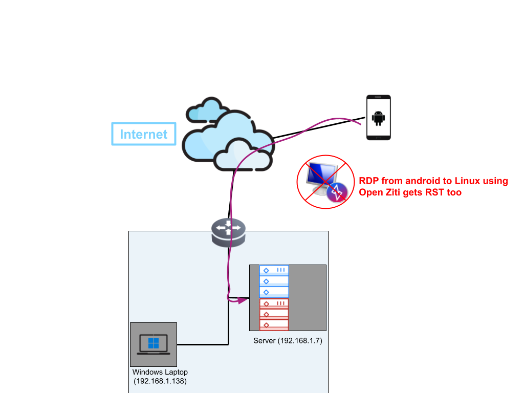

RDP Service gets RESET from end device
Since few days, when I try to connect to my laptop via RDP over OpenZiti network, my laptop sends a RST packet after successfully logged and connected, It happens few seconds later the connection.
Before (weeks ago), It worked perfectly and I never touch any configuration of this service.
I performed a packet capture from my laptop I want to connect with RDP, without ziti overlay and with ziti overlay and I can't see the problem... Together use TLSv1.3 and same type of packets are sent.
I don't know what to do.
Best regards
Hi @Damien,
When you get disconnected, RDP takes a moment to realize it and try to reconnect. I would look at the router logs to see if there are any events in the logs that are helpful and maybe look at the client side logs and the logs at the offloading tunneler. There is probably a clue in there somewhere.
How long does the connection stay connected before you notice the disconnect? Is it consistent?
You haven't upgraded the overlay network, or the tunnelers lately have you? If not, I think it might be hard to track this down.
Let's start by looking at all three logs (client tunneler, router, server-side tunneler) and see if any errors are logged?
I stay connected like 10 seconds maximum and it disconnect me, even when RDP reconnect successfully, it instantly disconnect the service.
I haven't upgraded anything.
Note that all other services runs properly, only RDP fail.

For more details, this only happens from a RDP of a Windows device. There is no problem with an RDP of a Linux device.
I'm confused. Does that mean Android RDP -> Windows fails but Android RDP -> Linux succeeds? If so, it's the same android device?
Is the RDP through the router exclusively? It's not using a windows tunneler to offload towards the RDP server port?
I'll let you look at these diagrams:
As we can see, there is a problem with my Android Tunneler.

There is no tunneler windows' side
On android, I am using https://play.google.com/store/apps/details?id=com.microsoft.rdc.androidx as RDP client.
Ok. Thanks. I didn't understand you at first but the diagrams help clarify. I scanned through those android logs and this time I do see one error in there:

I had the same problem too. I use a android device remote desktop to a windows 10 and a win server 2k8 via openziti network.
  • android tunneler RDP to win server 2k8 work perfect.
  • android tunneler RDP to windows 10 disconnect after short time (10-20s).

Okay, but I think the problem comes from the tunneler because I also tried to connect with the same RDP app without the Ziti overlay (port forwarding :grimacing:), and it worked perfectly without any disconnection.
Yes. It appears that two different people have confirmed there's some issue with the Android tunneler that will need to be looked into. (Thanks @vietdh for the confirmation that an older version works fine and welcome to the community and to OpenZiti!)
@vietdh I just want to clarify: the old version of Microsoft RDP for Android works fine. It is the latest version of RDP client that you have a problem with, did I get that right?
As we can see, yes.
I think it is a kind of change in the application's behavior from the old version of RDP to the current version that may disrupt the operation of the OpenZiti tunneler (because I have no disconnection problems without OpenZiti on the current version).
