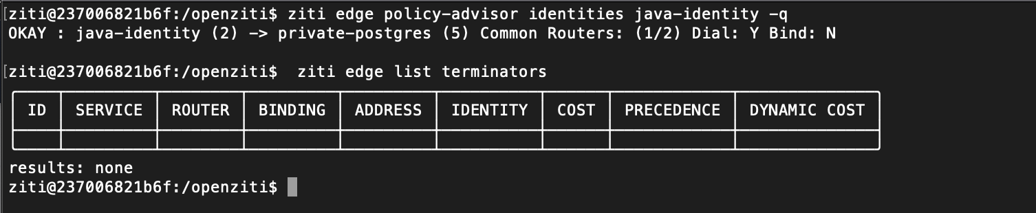

Weird… as the docker container is running… all up
mmmmmm. That seems like a bug then… Do this - leave ALL your stuff in place just like you have it, delete the bind service policy, and recreate it…
ziti edge delete service-policy postgres-bind-policy
… wait for like 60s or until you see the router notice that it no longer has the service… You will see things like “error creating terminator” in the logs…

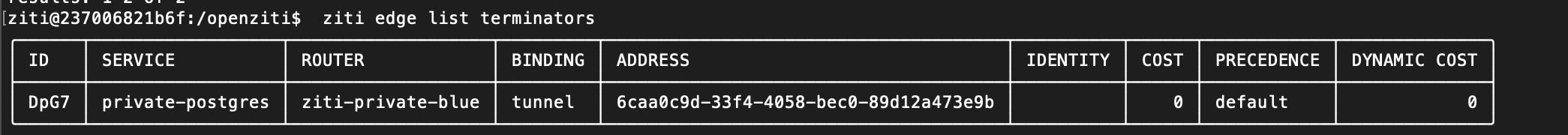

recreate the policy - wait for the router to notice the service
ziti edge create service-policy postgres-bind-policy Bind --identity-roles '@ziti-private-blue' --service-roles '#private-postgres-services'
you should see:
INFO edge/router/xgress_edge_tunnel.(*fabricProvider).establishTerminator: {service=[private-postgres] address=[5117ebbd-ca73-47f1-8031-8df2c7be18c2] terminatorId=[31OtEwzqLaWCbjDlajtS6O] routerId=[&{0xc0003f4600 -4LYBMothS map[]}]} created terminator
then ziti edge list terminators will have a terminator shown.
Once you see the terminator - then try the java app again
Sorry about this… the terminator came up…
But when I rerun the app… same error…
